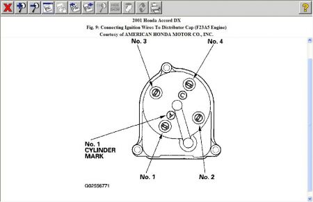

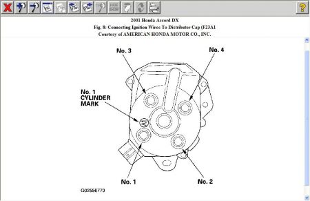

2001 Honda Accord distributor cap
JOSELRODRIGUEZ1985
  • 2001 HONDA ACCORD
  • 4 CYL
  • 2WD
  • MANUAL
  • 109,000 MILES
I took the distributor cap off to replced it but did not check the order in which they go can you please tell me the order of the spark plug wires on the distributor cap thank
Tuesday, November 18th, 2008 AT 1:09 PM
  • 75,992 POSTS
There you go-pick your cap
https://www.2carpros.com/forum/automotive_pictures/12900_fo_24.jpg
https://www.2carpros.com/forum/automotive_pictures/12900_fo1_6.jpg
Tuesday, November 18th, 2008 AT 1:40 PM
