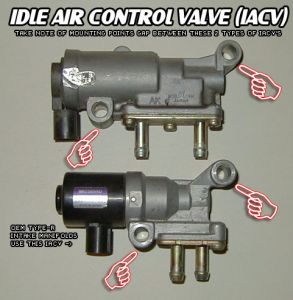

Ok i cleaned the throttle body with a special spray and engine is running far better with little or no rough idle. Where is the IACV motor located?
Thanks
Apr 10, 2009 at 1:36 PM
F4I_GUY
  • 3,302 POSTS
IACV is located at the back of the intake manifold on most hondas. It will have two 12mm bolts holding it in and 2 coolant hoses running to it. They usually look like this.
