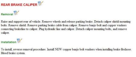

how to remove rear brake caliper on 2001 honda accord

https://images.2carpros.com/forum/automotive_pictures/261618_Noname_1797.jpg
