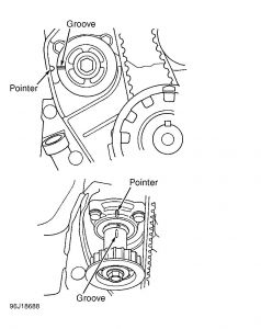

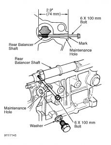

I just had my timing belt replace, but now the engine seems to be louder and vibrating...I have to shift gears quicker than I did before. Is it possible that the timing was set incorrectly??...It sounds totally different than what it did before. Any information you can provide will be greatly appreciated. Thanks.
May 13, 2008 at 12:56 PM
BMRFIXIT
  • 19,053 POSTS
you have two belts and they should be both changed I suspect the balance shaft is misalign
