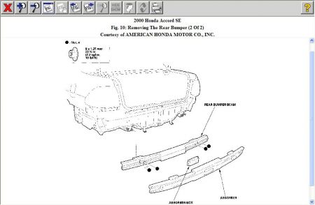

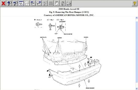

I need instructions on how to remove the bumper, replace the lens, and replace the bumper
2000 HONDA ACCORD
61,500 MILES • 4 CYL • FWD • AUTOMATIC
JIMHAYN
I have a broken lens on the right (passenger) brake light. In order to get to it I need to remove and replace the rear bumper. I need instructions on how to remove the bumper, replace the lens, and replace the bumper

Hi jimhayn, TAILLIGHT REPLACEMENT - SEDAN TAILLIGHTS 1. Open the trunk lid and pull back the trunk side trim 2. Disconnect the connectors from the taillight. 3. Remove the three mounting nuts, then pull out the taillight. 4. Install the taillight, and note these items:  Inspect the gasket; replace it if it is distorted or stays compressed.  After installing the taillights, run water over them to make sure they do not leak. BRAKE/TAILLIGHT BULB: 21/5 W TURN SIGNAL LIGHT BULB: 21 W Page 1 of 1 EXTERIOR LIGHTS -2000 Honda Accord SE 9/9/2008
https://images.2carpros.com/forum/automotive_pictures/192750_BumperRR2000AccordSedan01_1.jpg
https://images.2carpros.com/forum/automotive_pictures/192750_BumperRR2000AccordSedan02_1.jpg
