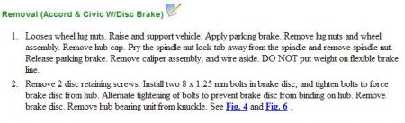

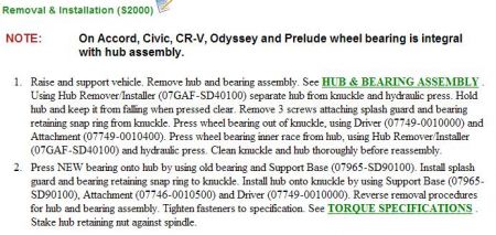

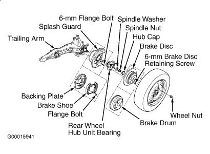

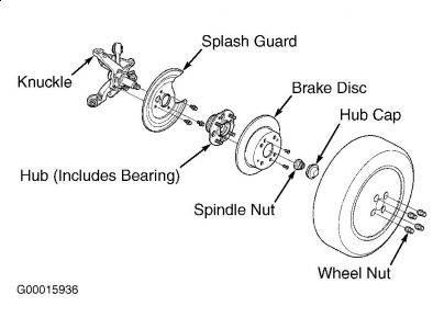

How do you replace the rear wheel bearing with 4 wheel disc brakes
Sunday, December 6th, 2009 AT 6:10 PM
MHPAUTOS
MECHANIC
31,937 POSTS
Hi there, i hope this is of help.
Mark (mhpautos)
https://www.2carpros.com/forum/automotive_pictures/61395_Graphic_130.jpg" alt="
https://www.2carpros.com/forum/automotive_pictures/61395_text_1_1.jpg" alt="
