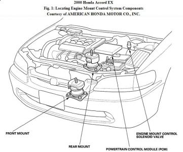

We have been told by our mechanic that we need to replace two motor mounts - left side & front to the tune of $400.00.
Is this something that I can replace myself, if so, how?

Hi Greg,
Here are diagrams of the front and rear engine mounts.
https://www.2carpros.com/forum/automotive_pictures/192750_EngineMounts00Accord6cylFig01_1.jpg
Removal and inistallations are rather straightforward. Remove any items that are obstructing and remove the holding bolts and nuts on engine mount. Use a jack to support and raise the engine/trans slightly to allow the mount to be removed.
