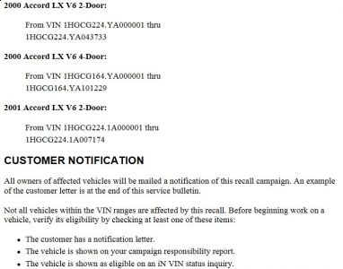

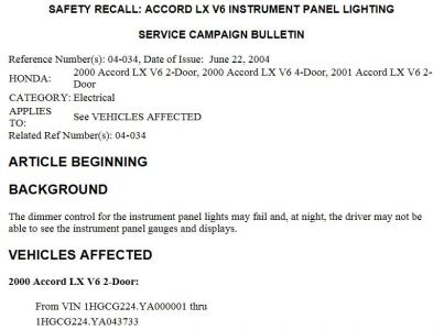

the instrument panel doesn't light up, that first I could "hit" the dashboard and the light will go back on, but now no more.
Any help on how to repair this problem?

Hi honda00, Thank you for the donation. There was a safety recall for this problem and you should contact the nearest Honda for more details.
https://images.2carpros.com/forum/automotive_pictures/192750_TSBInstrumentLight00Accord01a_1.jpg
https://images.2carpros.com/forum/automotive_pictures/192750_TSBInstrumentLight00Accord01b_1.jpg

My accord 2000 is an EX model, there is NOT a factory recall for this problem

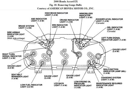

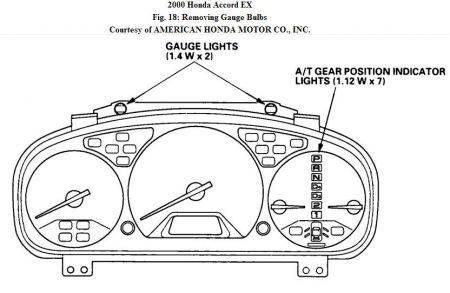

In this case you would need to remove the meter assy to check if it is caused by a bad connection, printed sircuit board fault or might even be blown bulbs. If you wish to do the job, I should be able to provide some diagrams and removal procedures. Here is a diagram of the bulb locations.
https://images.2carpros.com/forum/automotive_pictures/192750_GaugeBulbs00AccordEX01a_1.jpg
https://images.2carpros.com/forum/automotive_pictures/192750_GaugeBulbs00AccordEX01b_1.jpg
