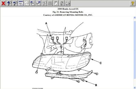

How do you get to the front drivers side turn signal to change the bulb?

Hi Tim, The diagrams shows the signal wire connector for the turn signal which has a small access hole. If you are unable to get at the bulb socket through it, then you need to partially remove the fender liner (from under wheel arch at tire) to gain access.
