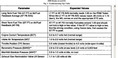

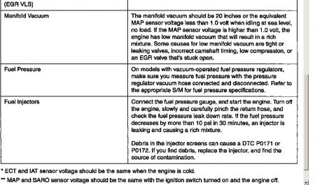

sorry i gave you the wrong code.the code was P0419 ON THE HONDA ACCORD. how can i fix this???????????
Jan 22, 2009 at 5:26 AM
ZACKMAN
  • CAR REPAIR CONTRIBUTOR
  • 4,202 POSTS
P0419 Secondary Air Injection System Relay "B" Circuit Malfunction. I have to do more research on this. In the mean time, you need to make sure that all the sensors are within range.
https://images.2carpros.com/forum/automotive_pictures/55316_00accorddiag1_1.jpg
https://images.2carpros.com/forum/automotive_pictures/55316_00accorddiag2_1.jpg
