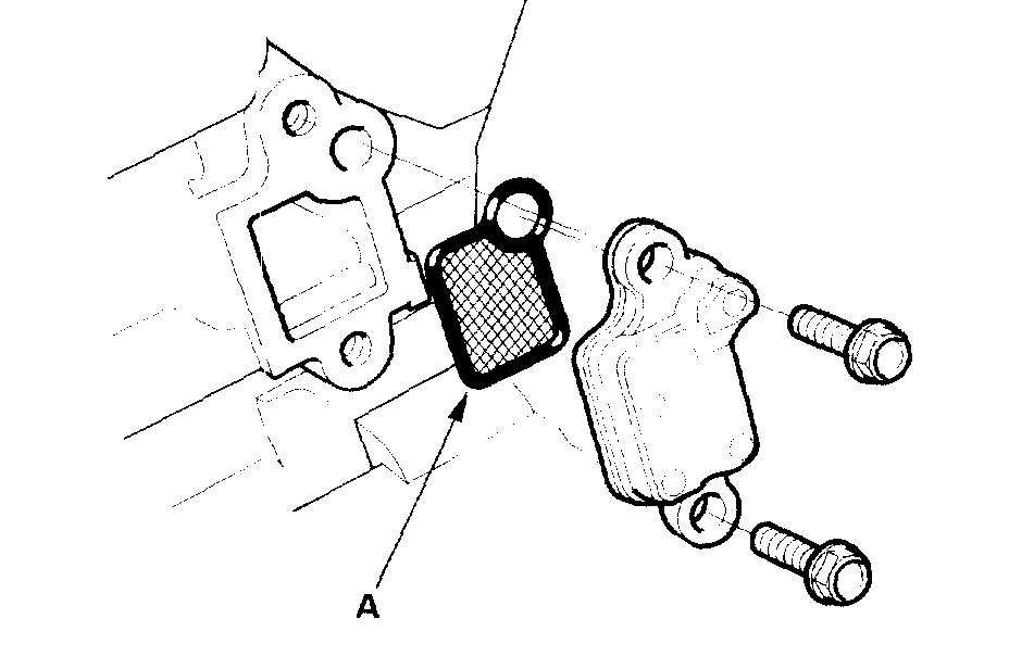

  • 110,240 POSTS
Okay, the code is related to valve timing control. Here is a flow chart. It requires an advanced scanner.

10. Remove the power steering pump and the auto-tensioner.
pic 1
11. Remove the VTC strainer (A), and check it for clogging.
Is the strainer OK?
YES - Go to step 12.
NO - Clean the VTC strainer, replace the engine oil filter and the engine oil, then go to step 14.
