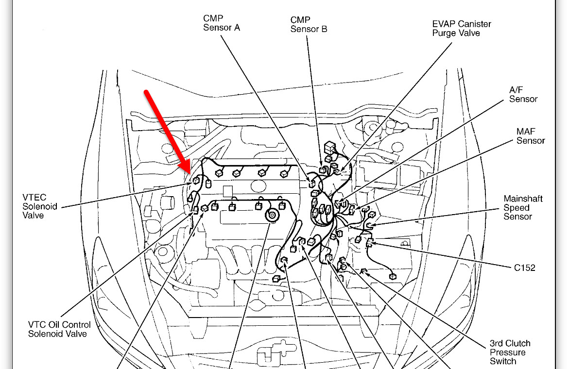

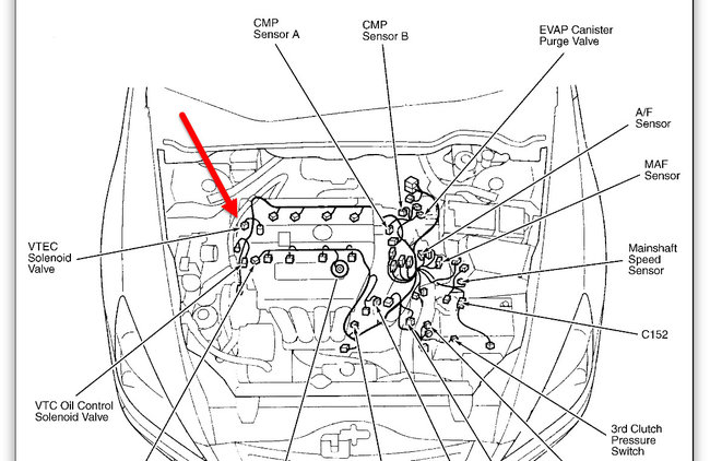

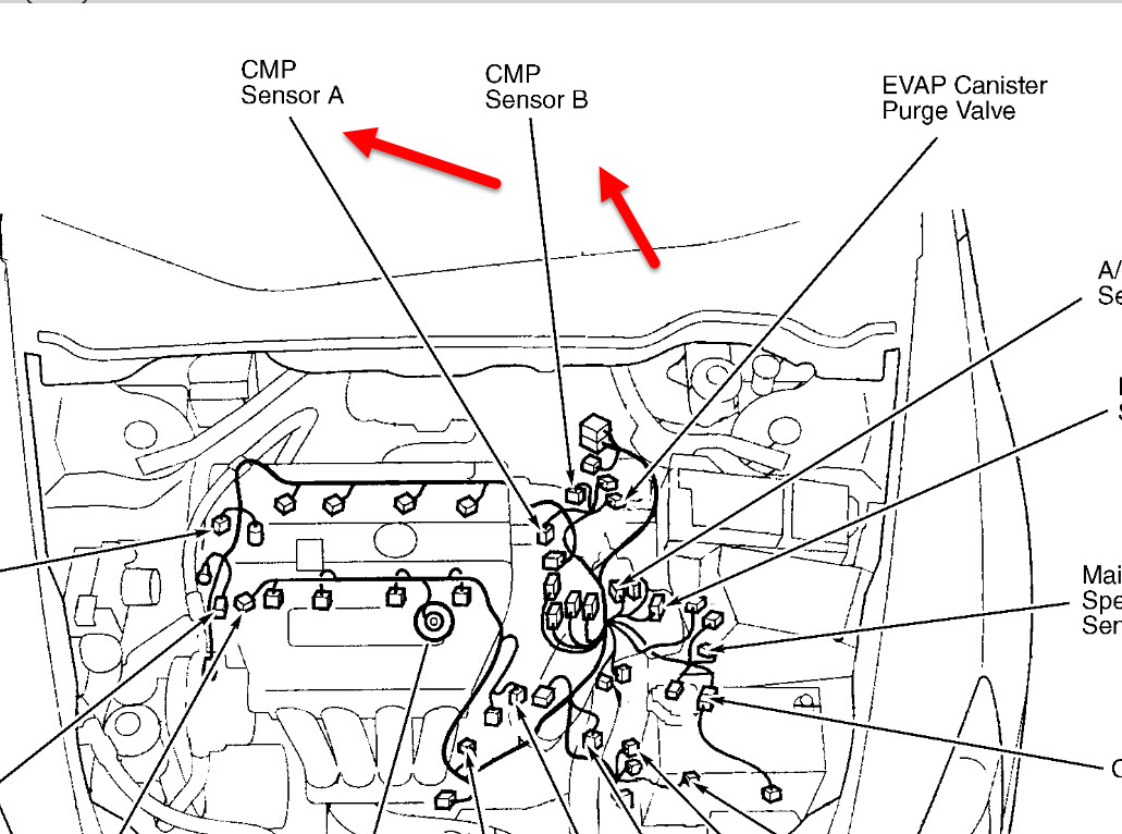

Cannot locate to change out. need help.
Jun 11, 2017 at 3:18 AM
HMAC300
  • 48,601 POSTS
see picture.. there are two in diagram.
Oct 10, 2020 at 2:24 AM
JERRY02
So do I need to change both or what? I appreciate your help.
HMAC300
  • 48,601 POSTS

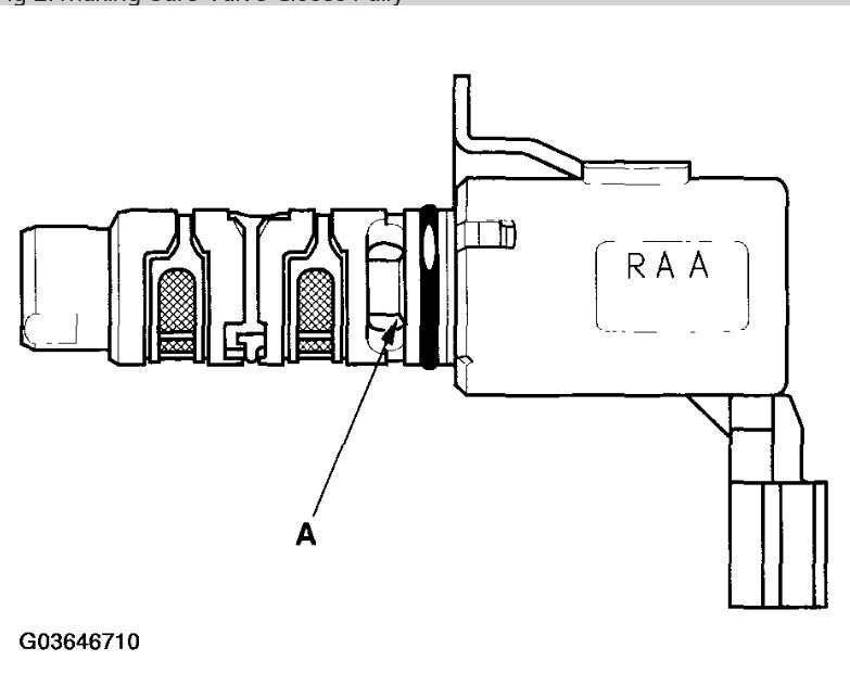

do not know the code so I do not know which one is bad. I would do them both.
JERRY02
It is po341.
HMAC300
  • 48,601 POSTS
first thing you have to do is check the VTC solenoid to see if it is working or has a plugged screen, then have a mechanic check for a stretched timing chain. after replacing both sensors then have a mechanic put them in sync with the crank sensor as this must be done with a scanner. it is like setting timing but you need a scanner to do it.
