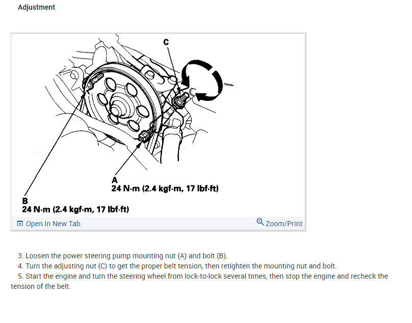

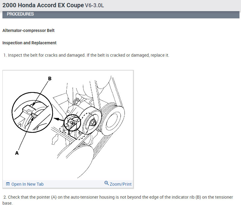

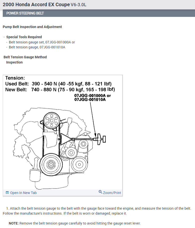

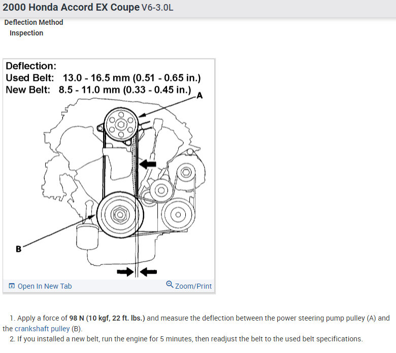

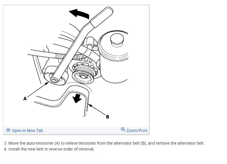

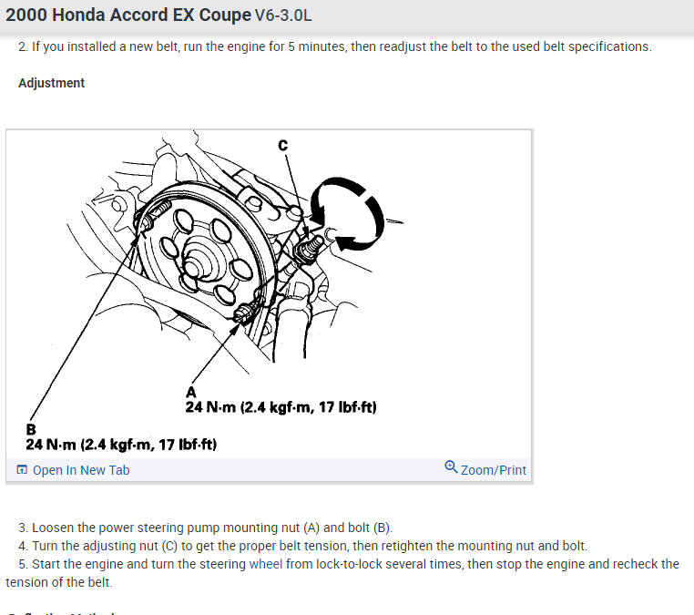

It sounds like you might have a noisy serpentine belt.
Many times a worn serpentine belt can make a screeching noise on acceleration.
As drive belt components age, with constant hot and cold cycle the rubber on the belt wear and glaze over and lose traction. Which creates the screeching noise on acceleration as the belt will slip.
