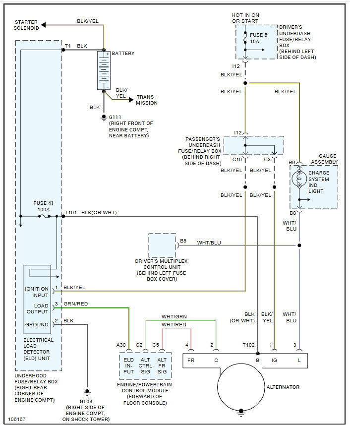

I have bought a new battery and alternator and my batt. indicator still is coming on right away. i thought maybe i should replace the 100amp block fuse in the relay box but it does not look blown although it could be i did arch the alternator about 3 times off the manifold by accident while the batt. was hooked up but only for a sec. when the wrench touched i am at a loss but for somereason i feel it may be something simple like a fuse PLEASE HELP.....!!!!!!
Jan 23, 2010 at 12:42 PM
  • 75,992 POSTS

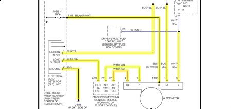

Hi sirrjon3030, Welcome to 2carpros and TY for the donation Check fuse no.6 15amp in driver's underdash fuse/relay box behind left side of dash and fuse no.41 100amp if the fuse and the 100amp fusible link are okay-Get the electrical load detector in underhood fuse and relay box ( right rear corner of engine compartment ) and the computer controlled of the field generation driver circuit.
https://images.2carpros.com/forum/automotive_pictures/12900_a1_4.jpg
https://images.2carpros.com/forum/automotive_pictures/12900_a2_4.jpg
Here is the wiring diagram (whole) Check out the images (below).
