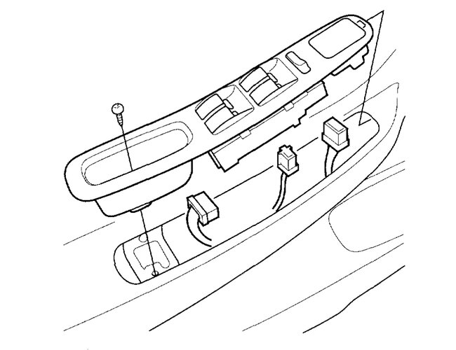

My windows do not open or close properly, and one does not open at all. What is the average cost to repair this problem? I know nothing about cars obviously... but I think that I need new tracking for the windows.

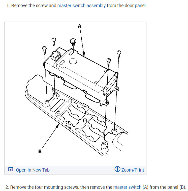

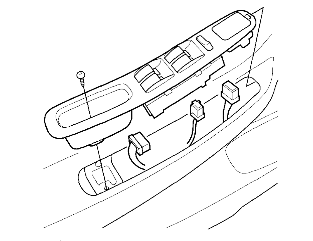

Most of the time the master window switch has gone out, here is how to change it out, but you should check the fuses first. Check out the images (below). Please let us know what happens.
