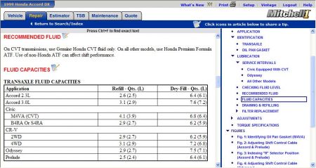

I want to change my transmission oil. Please what type would you recommend as it is not specified in the manual.
Jun 21, 2008 at 9:27 AM
  • 75,988 POSTS
Use honda premium formula automatic transmission fluid.
