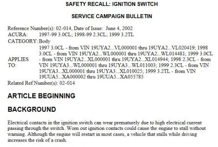

The symptoms described seems to indicate a faulty ignition switch. This is the Recall Bulletin.
https://www.2carpros.com/forum/automotive_pictures/192750_TSBIgnitionSwitchHonda_1.jpg
When turning the ignition switch to START position, does all the dashlights flickers or goes off?
Distributor fault would not show on the MIL if it is the ignition coil that is faulty.

When the ignition switch is not providing the correct signal to the system, the immo would be armed resulting in non startiing.
