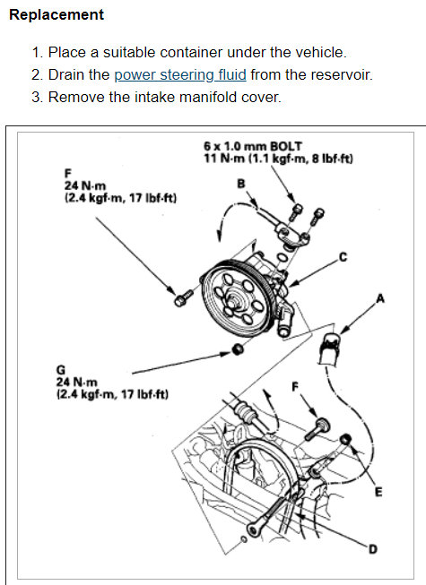

power steering fluid leaks bad seems to be coming from the pump but I can't get to it. How do I get to it to change it? What else could it be?

This sounds like the front seal of the pump is bad I would replace the pump here is a guide top show you what you are in for when doping the job.
https://www.2carpros.com/articles/how-to-replace-a-power-steering-pump
Here is how it will be like for your car. Check out the diagrams (Below). Please let us know if you need anything else to get the problem fixed.
