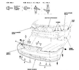

You short piece on how to do this simply said to remove the five retaining bolts, but don't you need to remove the bumper skin first to gain access to the five bolts????

Hello Thanks for the donation. Yes, you must first remove the front bumper to gain access to the electrical plug ins and the 5 bolts. The bolts and clips for the bumper to be removed are shown below..
https://images.2carpros.com/forum/automotive_pictures/261618_Noname_232.jpg
