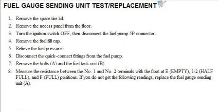

Hello, I just put a full tank of gas in my car. I've already driven 100 miles and my gas meter did not budge a bit. I believe the meter has malfunctioned. How can I fix it?

suspect faulty fuel gauge sending unit

normal wear and tear will cause this part to fail. would you like replacement procedures?

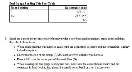

BLUELIGHTNIN6
  • 16,542 POSTS
https://images.2carpros.com/forum/automotive_pictures/261618_Noname_1118.jpg
https://images.2carpros.com/forum/automotive_pictures/261618_Noname2_321.jpg

hi. is there a way i can get a more detailed description like with pictures and everything. i know nothing about cars and i lift the spare tire lid then i got lost. that would be great thank you!!
also is a fuel gauge also named a fuel pump?
