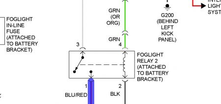

the fog light on my honda accord is permnently on ,is there a relay some where which controls this,as it is suppost to go off when you switch the lights off? There is no relay by the batery bracket on my car ,its a right hand drive model if this makes any difference.It is a stock system on a UK spec car,fog light is on even when ignition is switched off??

Check and test the fog light relay no.2 attached to the battery bracket
https://images.2carpros.com/forum/automotive_pictures/12900_fog_light_relay2_1.jpg

If the fog lights aren't stock - I know many people wire them in parallel with the parking lights. So whenever you put the parking lights on (and headlights), the fog lights come on.
Or, again if they are not stock fog lights - the person may have installed them after one of the fuse boxes which get power as soon as the car turns on, resulting in fog lights that would be on even if the headlights or parking lights arent.
