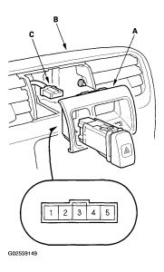

1999 Honda Accord 4 cyl Two Wheel Drive Automatic
how can i replace the clock bulb?
Jan 14, 2009 at 5:36 PM
DAVE H
  • 13,384 POSTS
Replacement Remove the clock (A) from the center panel (B). Fig. 2: Removing The Clock From The Center Panel Courtesy of AMERICAN HONDA MOTOR CO., INC. Disconnect the 5P connector (C) from the clock. Remove the clock.
