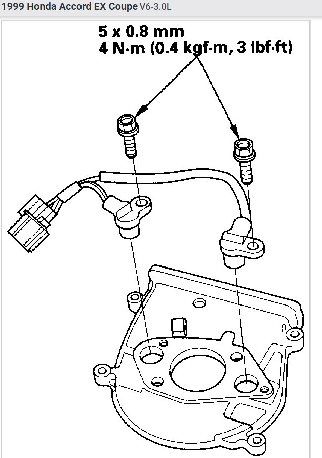

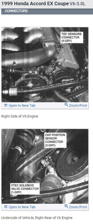

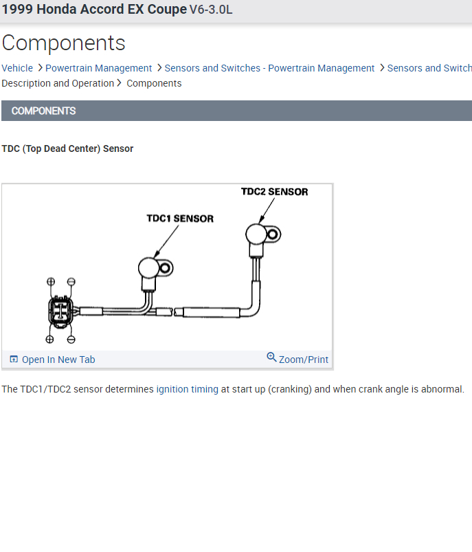

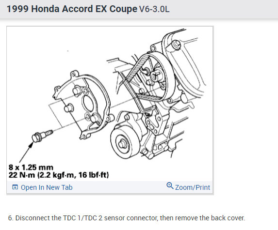

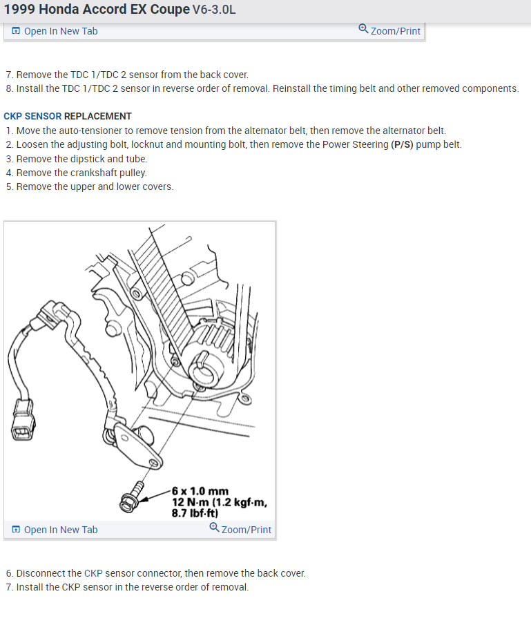

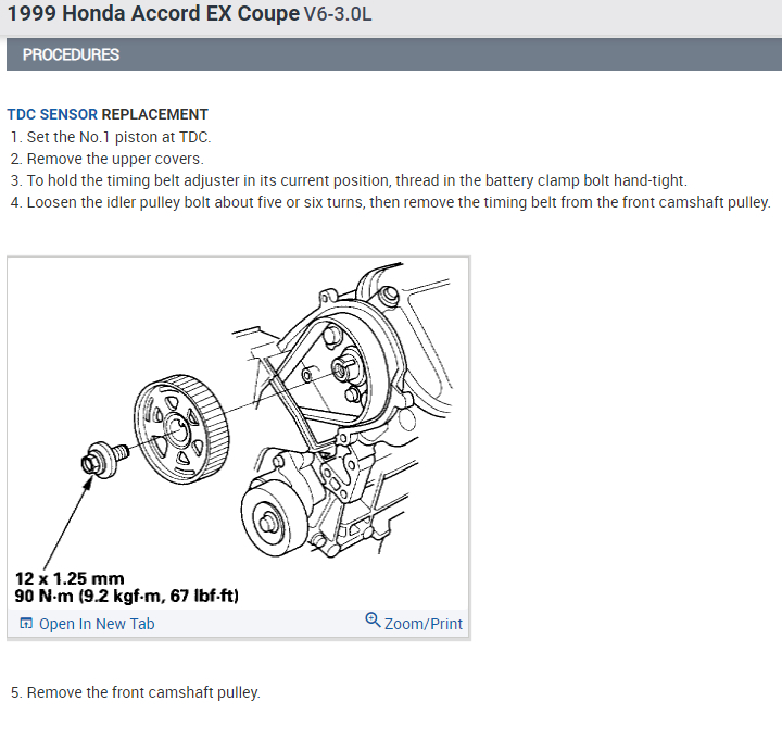

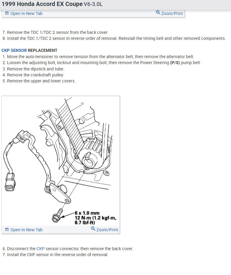

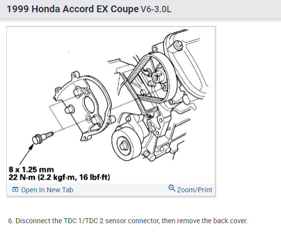

It sounds like you might have a faulty crank position sensor.
Are you able to start the car back up after it stalls?
Is your check engine light illuminated? When a car unexpectedly stalls, it produces trouble codes, which can point to the issue.
https://youtu.be/vMwTzURWXmk
https://www.2carpros.com/articles/engine-stalls

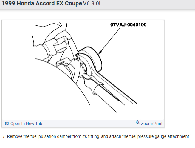

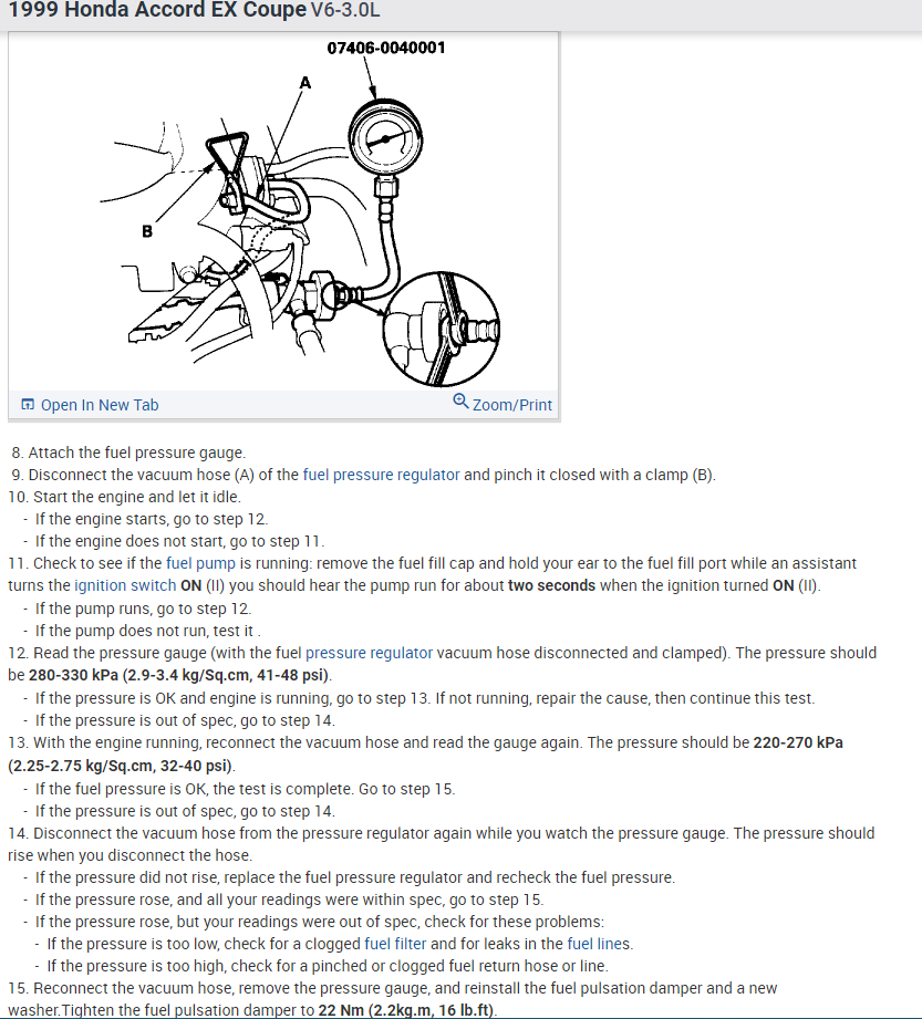

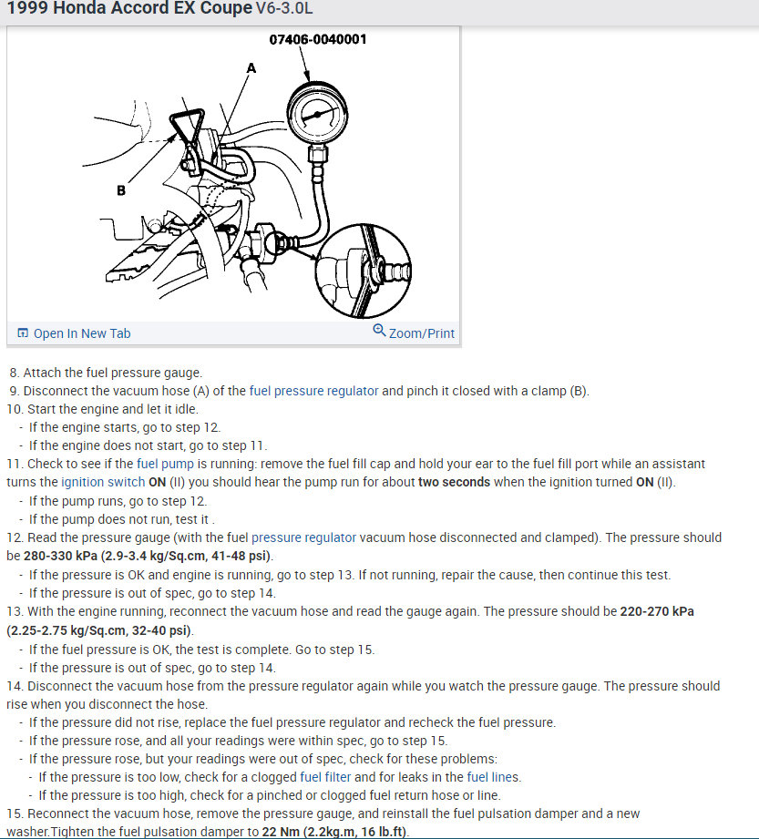

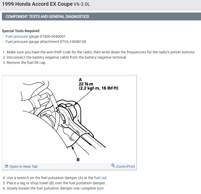

You can also test your fuel pump to make sure if it is indeed bad. You should have 41-48 PSI of fuel pressure.
Here is a helpful article of how to check the fuel pressure:
I have attached the crank position sensor replacement procedure as well as fuel pressure check for your reference.
