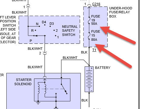

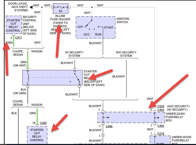

MRPATRICK
Car acts like a dead battery. I can jump start it just fine and it will run as long as I need it to. But when I turn it it won't start again unless I jump it. But I just tested the battery with a volt meter and it read 12.4 volts.
Dec 11, 2020 at 3:55 AM (Merged)
HMAC300
  • 48,601 POSTS
12.4 is very minimum for battery have it tested for condition including load test. check items in pic if you have a security system reset it if no manual look online.
