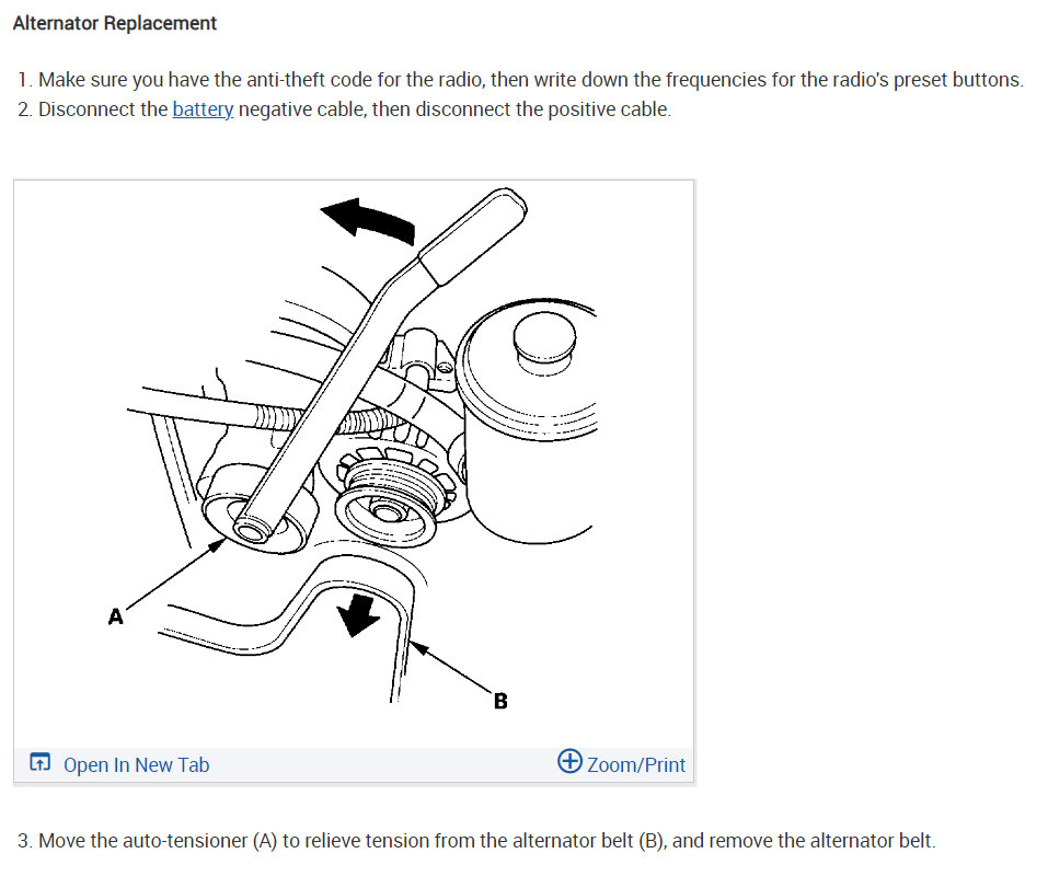

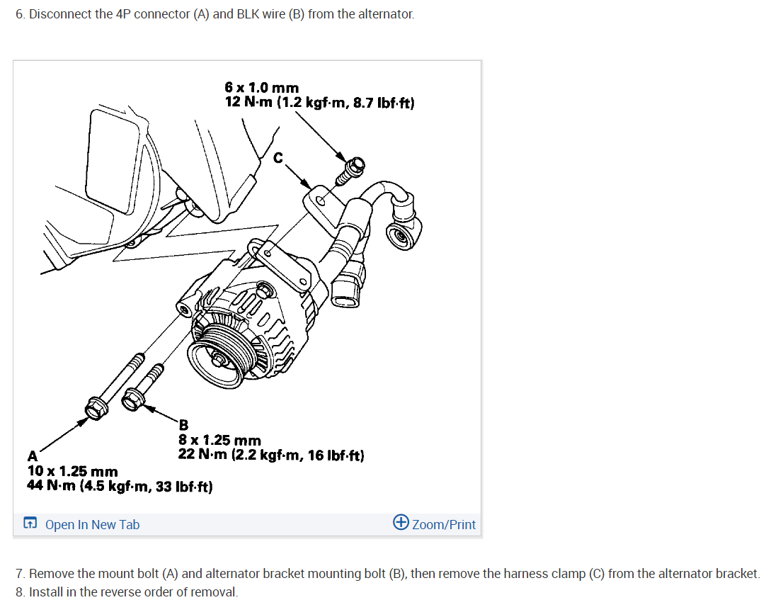

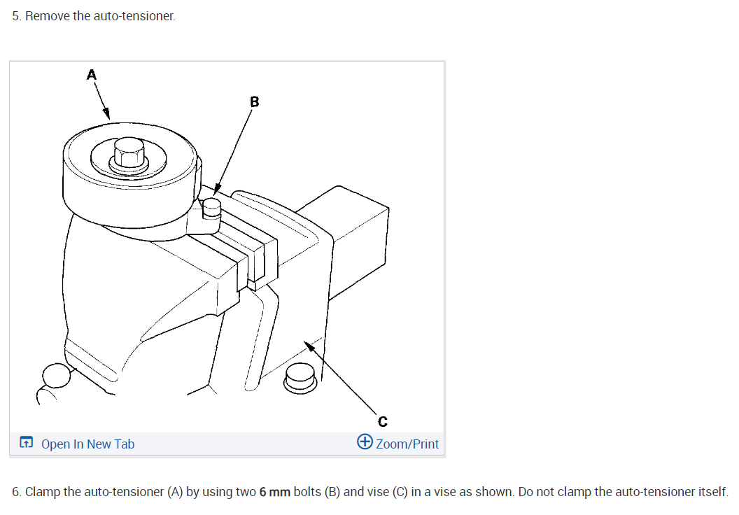

Blinking warning lights, discharged battery, dying engine. I'm suspecting a bad alternator, or voltage regulator.
1. How can one tell a bad alternator from a bad regulator without removing the alternator and having it tested?
2. Where is the voltage regulator located on the 99 Accord V-6?
Thanks

The voltage regulator is inside the alternator.
Honestly, rebuild kits for alternators are hard to come by, I would just replace the whole unit with a new or rebuilt one.
Sep 16, 2009 at 12:12 PM
  • 55,512 POSTS

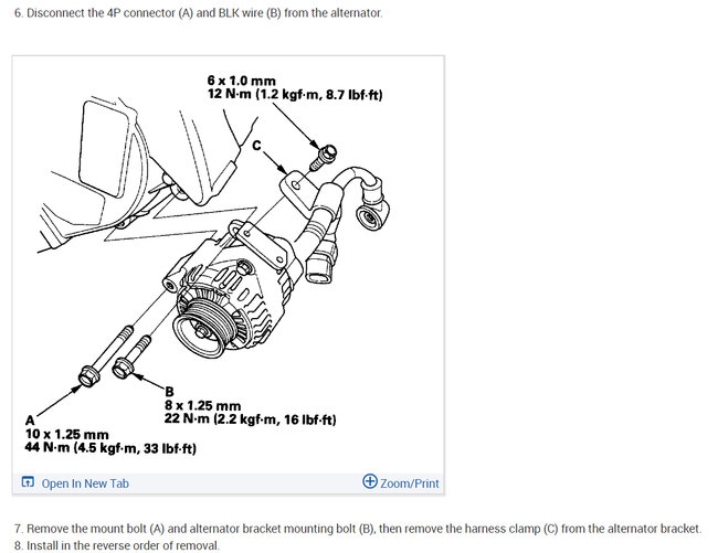

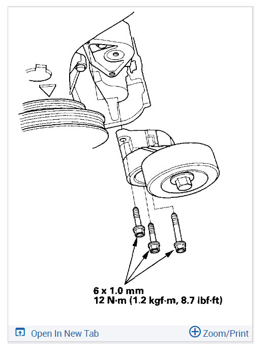

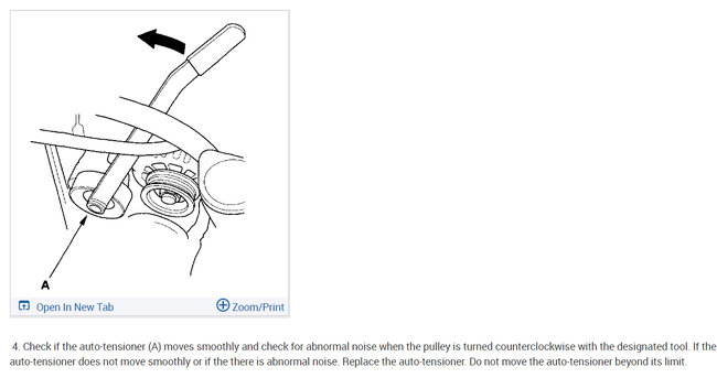

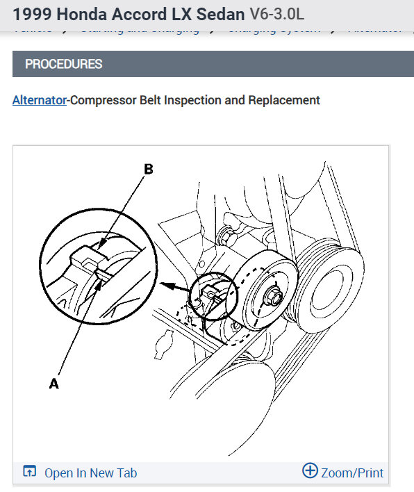

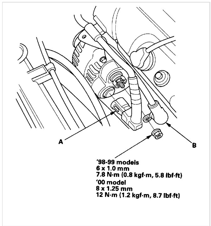

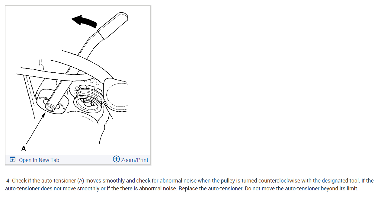

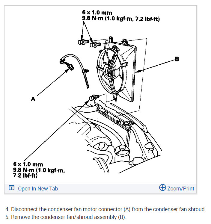

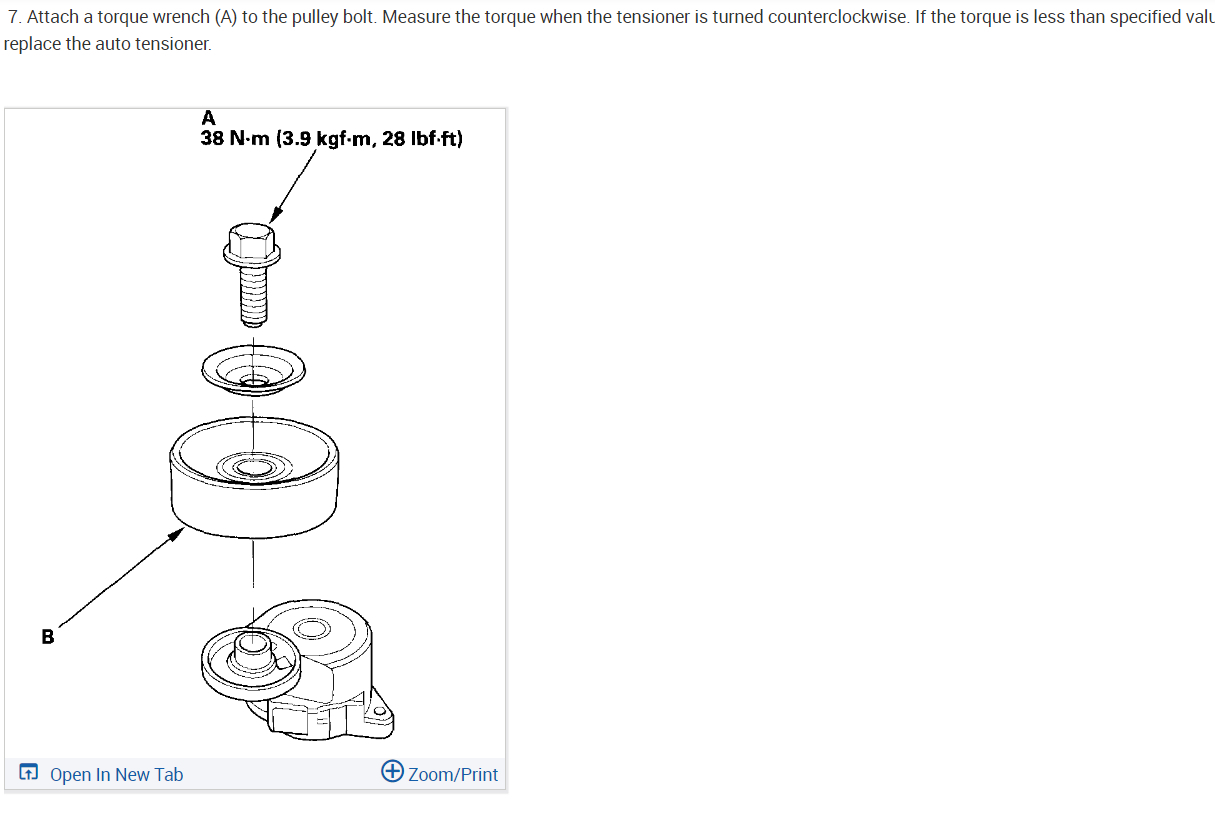

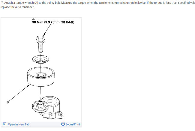

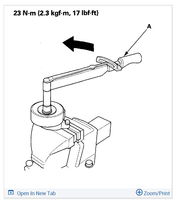

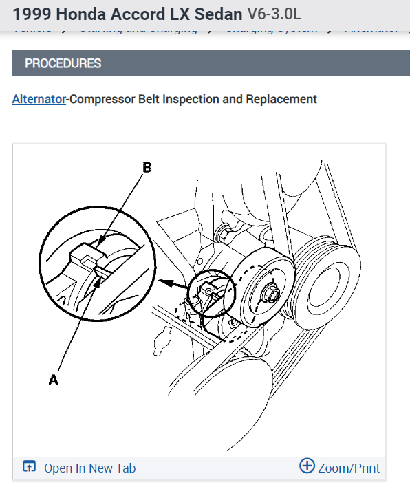

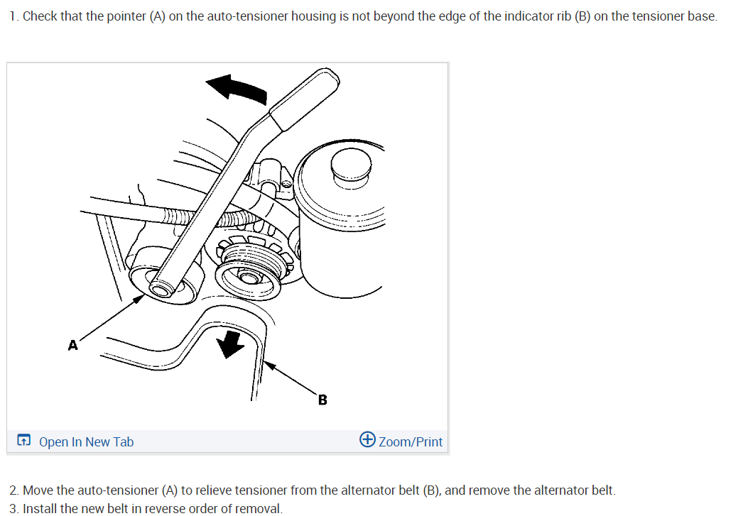

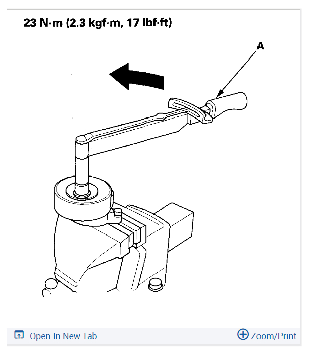

Here is how to change the alternator out. Check out the images (below). Let us know if you need anything else.
