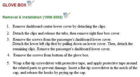

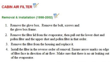

How do I access the passenger compartment air filter to put in a new one?

BLUELIGHTNIN6
MECHANIC
16,542 POSTS
SPONSORED LINKS
Wednesday, July 14th, 2010 AT 1:42 PM
