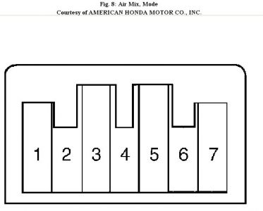

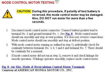

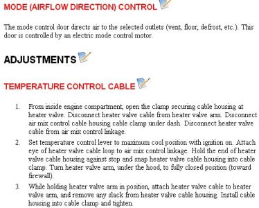

The air conditioner is only blowing through the defroster, not through the dash vents. It is blowing cold air.
