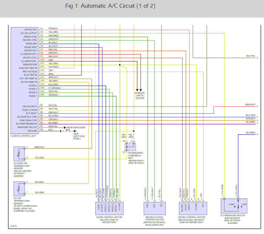

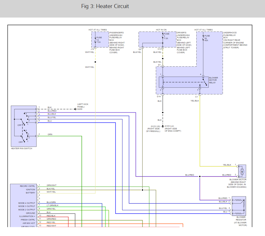

Today when I tried to turn on the air conditioner by rotating the fan switch only the fan turned on and none of the little lights illuminated over the various functions on the AC control panel and all I get is warm air from the vents. The fan switch works fine but none of the other buttons function.
I have continuity through every fuse on the vehicle and I removed the dash panel and found all connections around the control panel to be secure.
Dec 17, 2009 at 8:13 PM
KHLOW2008
  • 41,814 POSTS

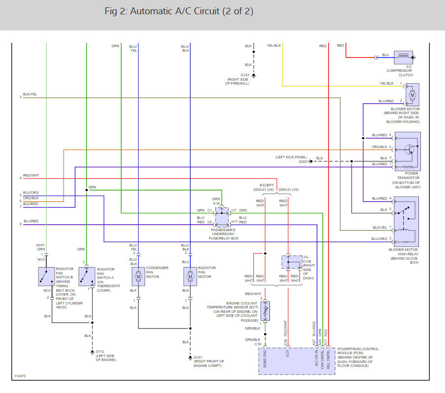

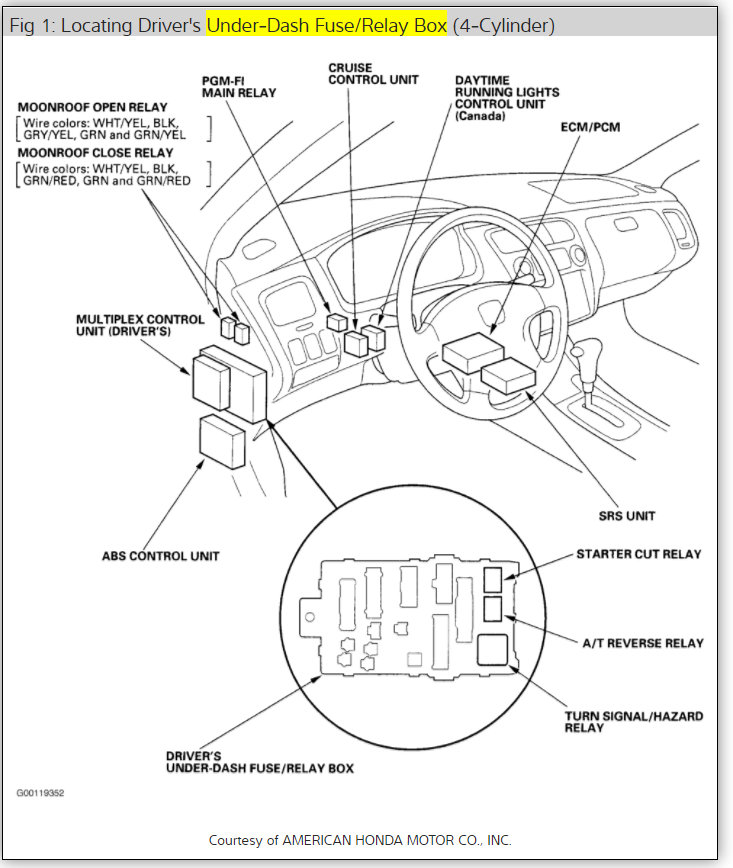

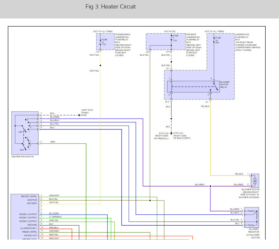

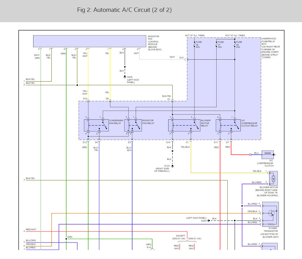

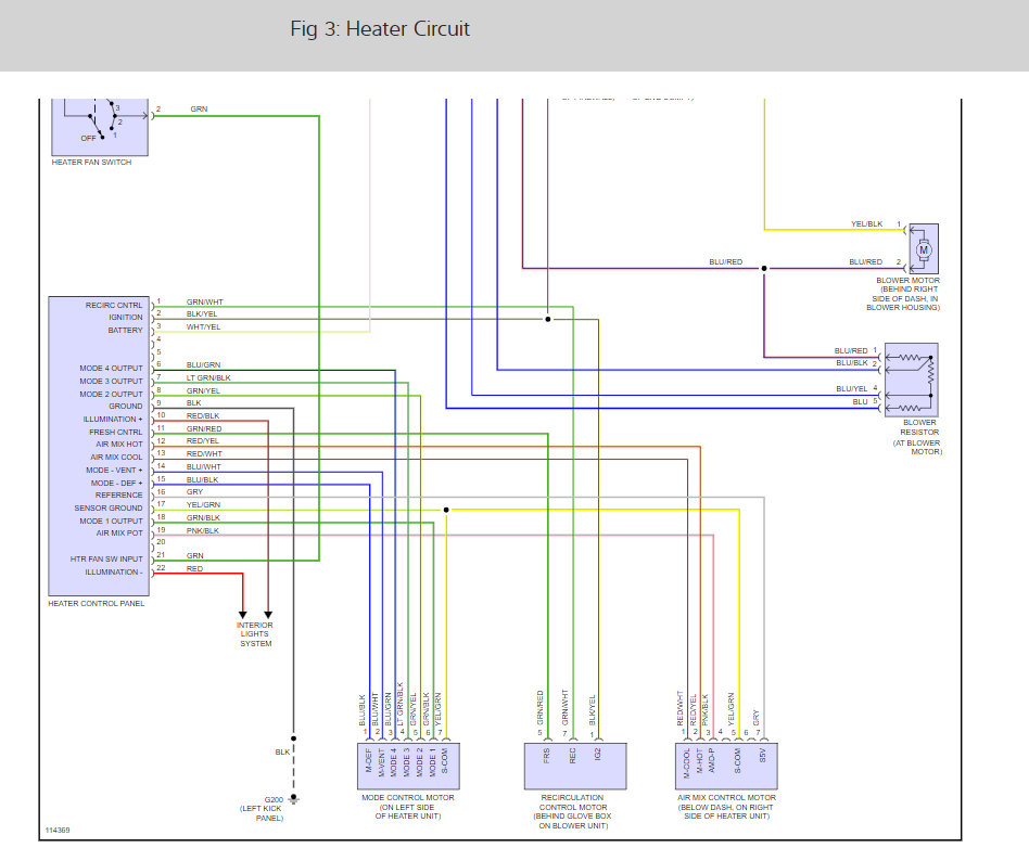

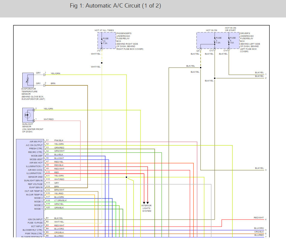

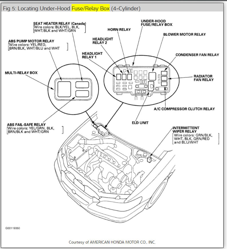

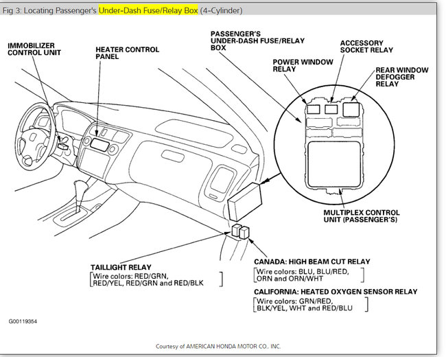

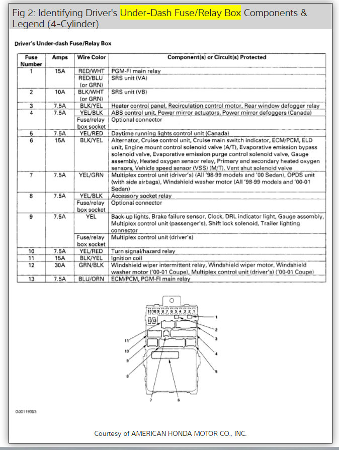

Hi Cherry107,
It sounds like you have a fuse out #13 7.5 amp here is a guide t help you test it with wiring diagrams of the climate control so you can see how it works and the fuse location are featured as well.
Check out the diagrams (Below). Please let us know what you find. We are interested to see what it is.
Dec 19, 2009 at 2:41 PM
ZANYJB
It was the fuse in my car FYI

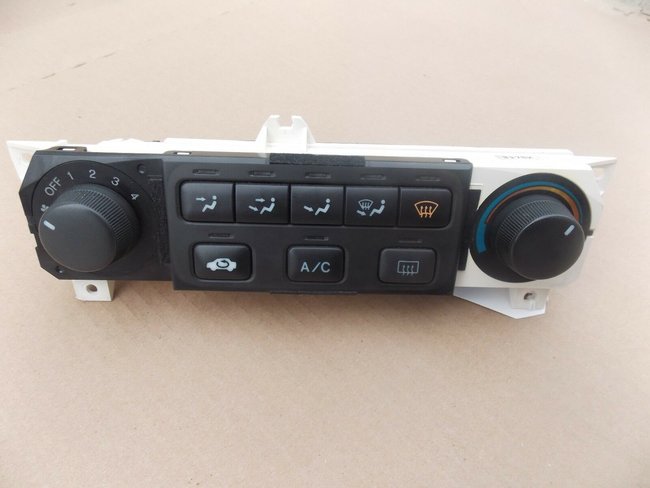

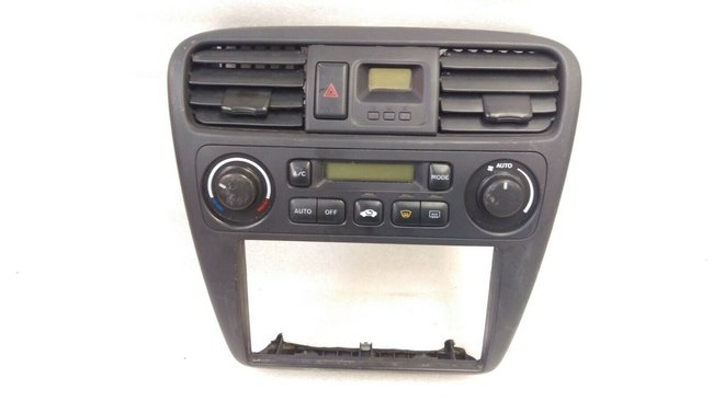

JACKHONDA00
I know my climate control module needs to be replaced on my 2000 Accord LX. The one I have now has all of the manual buttons up top. Can I replace it with the version that has a digital screen? See picts...
Oct 15, 2019 at 11:18 AM
STEVE W.
  • 15,348 POSTS
Welcome to 2CarPros. The short answer is no. This is because the two controls use different internal programming and the body module would need to be re-programmed to make it work. That isn't something that can easily be done.
