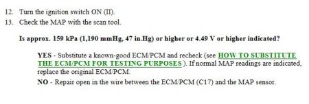

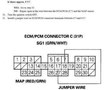

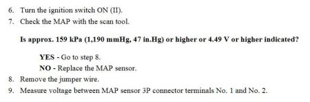

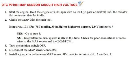

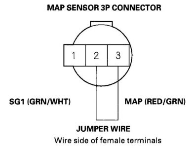

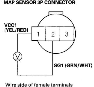

My wife has a 98 accord with 146000 miles. It just recently started idling very roughly, occasionally stalling, and has a very bad hesitation. Occasionally it wont have the problem until its a couple miles down the road, but, it then persist the rest of the drive. I had the engine scanned and it read P0108, Map Baro high input. Based upon advice you gave to another user i replaced the map sensor, but it did not solve the issue... Is their anything else I need to do once I installed the new sensor, if not whats next?

Hi LiabilityDan, Here are the diagnostic procedures.
