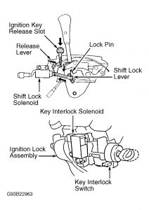

my problem is not inserting and starting, but getting the key out of the ignition. The vehicle will turn off and it will restart and is driveable. But when I put it in park, the key will not come out. We took care of the recall situation several years back and have not had this problem until now.

https://images.2carpros.com/forum/automotive_pictures/99387_Graphic1_92.jpg
Key interlock system prevents ignition key from being removed from ignition lock assembly unless shift lever is in Park. When ignition key is in ignition lock assembly, key interlock switch closes, providing voltage to key interlock solenoid and interlock control unit. If shift lever is not in Park (parking pin switch on), interlock control unit energizes key interlock solenoid by completing ground circuit. When key interlock solenoid is energized, ignition key cannot be removed from ignition lock assembly. Key interlock switch and key interlock solenoid are located on ignition lock assembly. Parking pin switch is located on bottom of shift lever. Interlock control unit is located behind left side of dash, near steering column.
