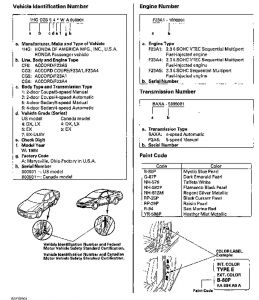

Hello:
I am trying to identify the model of my 1998 honda accord. It is a 4 door, 5 speed, 4 cylinder v-tech. I have looked everywhere I can think of including the registration, owner's manual, door panel, underhood, etc. How can I identify this car so I can get an on-line manual from Mitchell?
Thank you
