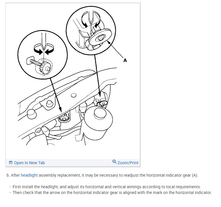

The headlight bulb replacement on this vehicle is straight forward.
After opening the hood, you will have access to the back of the headlight housing.
Locate the back of the bulb you want to replace. Remove the wire connector by pulling up on the tab. Then twist of the light bulb (counterclockwise).
Simply reverse the process for installation.
