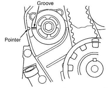

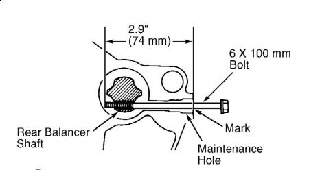

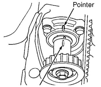

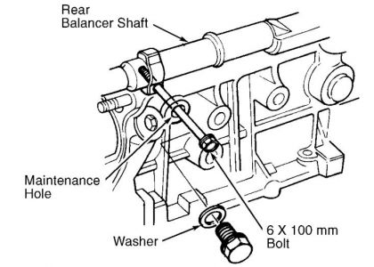

Can anyone provide any information on how to realign the balance shaft for a 98 Honda Accord.

Hi Robert, Here are the diagrams. Locking rear balancer shaft.
https://images.2carpros.com/forum/automotive_pictures/192750_Balancer98Accord01_1.jpg
https://images.2carpros.com/forum/automotive_pictures/192750_Balancer98Accord02_1.jpg
Aligning front balancer
https://images.2carpros.com/forum/automotive_pictures/192750_Balancer98Accord03_1.jpg
https://images.2carpros.com/forum/automotive_pictures/192750_Balancer98Accord04_1.jpg

There are 2 shaft. I already have the crank and cam shaft in line. I kind of understand the right balance shft. Do I leave the crank and cam shaft at TDC and then rotate the right shaft until it's align or do I rotate all shaft together. Once done, how about the left shaft. How is the left shaft suppose to align.

The crankshaft should be aligned at TDC and with right shaft locked, the balancer shaft would not be turning.
Install and get the left shaft to match the other shafts. After installation of the belts, all shaft markings should match accordingly , crankshaft at TDC with camshaft aligned, balancer shafts as per diagrams.

I followed the diagram and now have the balance shaft in line. I put all back together and the car is running like a champ.
