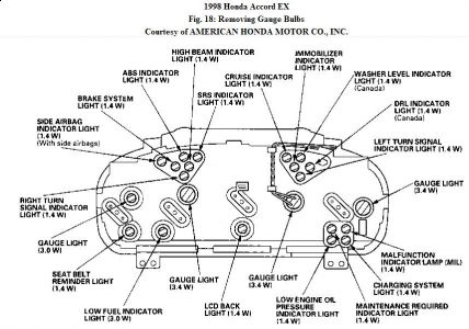

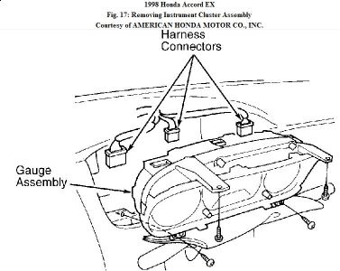

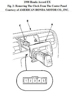

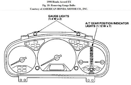

How to install clock,and several small dash light bulbs.

Hi handout1, The meter cluster or clock assy has to be removed to replace the bulbs. Clock Removal 1. Remove the clock (A) from the center panel (B).
https://images.2carpros.com/forum/automotive_pictures/192750_Clock98Accord_1.jpg
2. Disconnect the 5P connector (C) from the clock. 3. Remove the clock. 4. Bulb can be replaced. REMOVAL & INSTALLATION WARNING: Deactivate air bag system before performing any service operation. DO NOT apply electrical power to any component on steering column without first deactivating air bag system. Air bag may deploy. INSTRUMENT CLUSTER/GAUGE ASSEMBLY Removal & Installation Tilt steering column fully down. Cover steering column with protective cloth. Remove 2 screws and 2 clips to remove instrument cluster trim. Remove 4 instrument cluster mounting screws. Gently pull instrument cluster from instrument panel. Unplug instrument cluster harness connectors. Remove instrument cluster. See Fig. 17 . To install, reverse removal procedure.
https://images.2carpros.com/forum/automotive_pictures/192750_InstrumentCluster98Accord_1.jpg
https://images.2carpros.com/forum/automotive_pictures/192750_BulbGauge98Accord_1.jpg
https://images.2carpros.com/forum/automotive_pictures/192750_BulbGauge98Accord01_1.jpg
