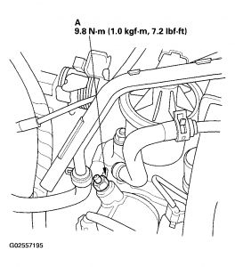

my radiator cap was bad and sucked a lot of air into the system it was burped by a pro tech before i found out the cap was bad now ther is air in the line again how do i burp it my self

with the engine cold/cool, start the engine Loosen the air bleed bolt (A) in the thermostat housing, then pour Honda All Season Antifreeze/Coolant Type 2 into the radiator to the bottom of the filler neck. Do not let coolant spill on any electrical parts or the paint. If the any coolant spills, rinse it off immediately. Tighten the bleed bolt as soon as coolant starts to run out in a steady stream. bleed bolt location
https://images.2carpros.com/forum/automotive_pictures/266999_bleed_2.jpg
