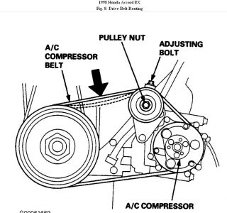

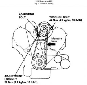

My car has a squealing noise when cold start recently.
One of drive belt looks too tight (lower level belt, not alternator belt).
I am appreciate if you can show me about how to adjust belt.
or another reason?
I changed water pump and all belts at dealership when 300,000 miles.

Hi dahua.huang, Squealing noises are due to belts tension too loose and not too tight. The diagrams shows the adjusting bolts.
https://images.2carpros.com/forum/automotive_pictures/192750_DriveBelt98Accord6cylFig06_1.jpg
https://images.2carpros.com/forum/automotive_pictures/192750_DriveBelt98Accord6cylFig08_1.jpg
