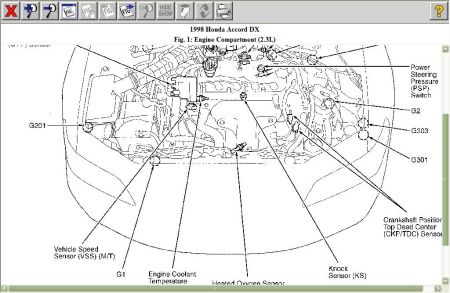

1998 Honda Accord 1998 accord speed odometer stopped worki
1998 HONDA ACCORD
160,000 MILES • 4 CYL • 4WD • MANUAL
JNIYA
I purchased a new sensor.Now I need to know the location and how to replace it.
Jul 7, 2008 at 8:21 AM
  • 75,992 POSTS
The vehicle speed sensor is located on top left of transaxle that's if its an electronically controlled transmission-also another could be on the speedo head-
https://images.2carpros.com/forum/automotive_pictures/12900_vss_3.jpg
