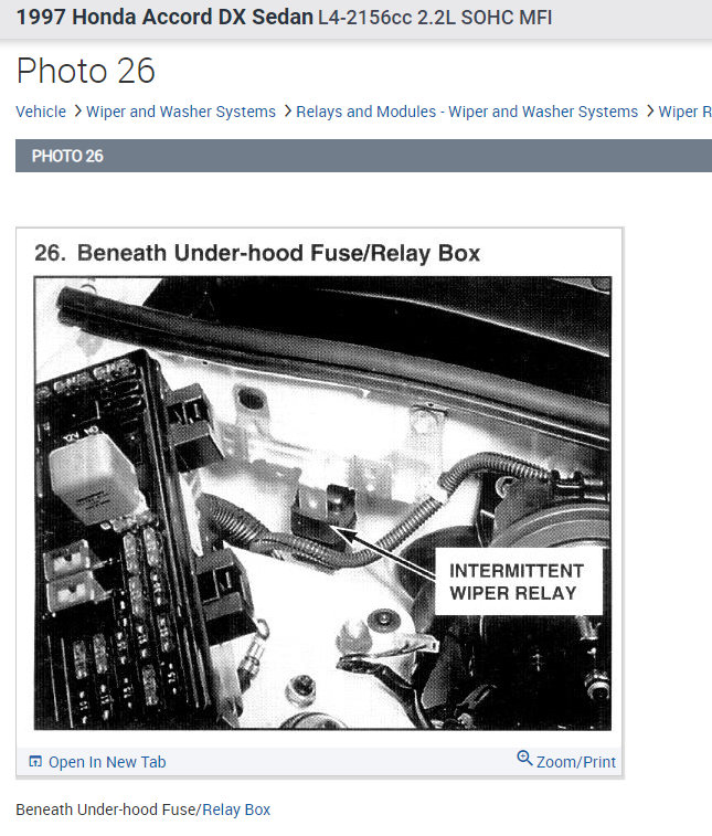

It's always a good idea to make sure the relay is functional before replacing the wiper motor.
The relay is located under hood fuse box (see picture).
Do a visual check for any corrosion or bunt pin(s). You can also test the relay as well:

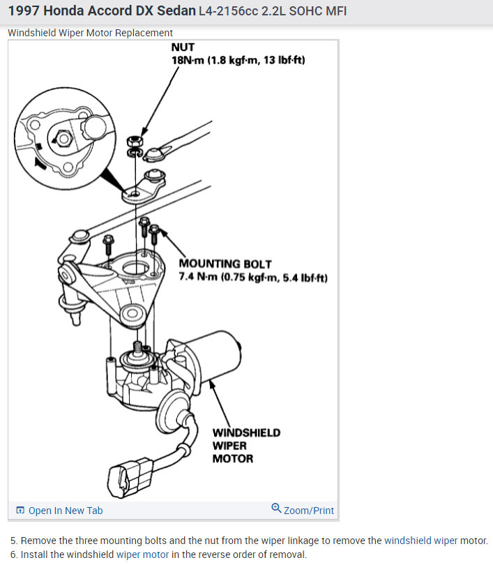

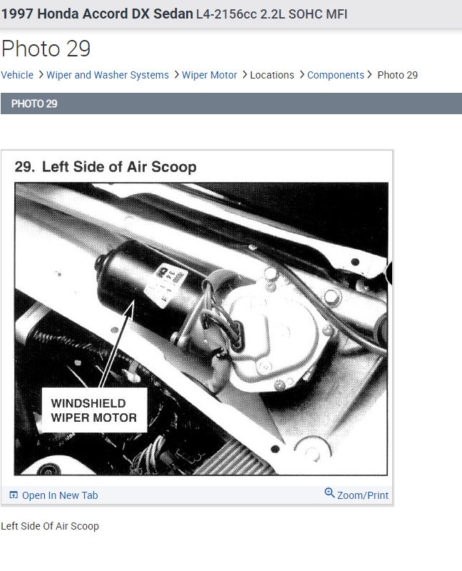

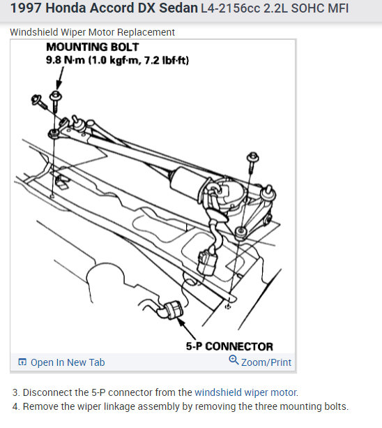

The wiper motor is located on the left side of the air scoop/cowl.

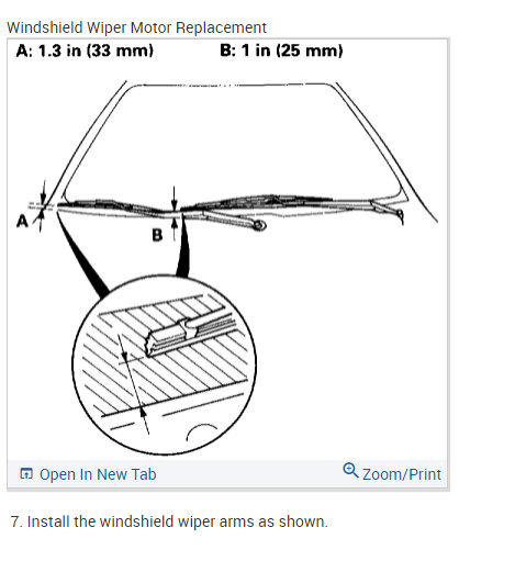

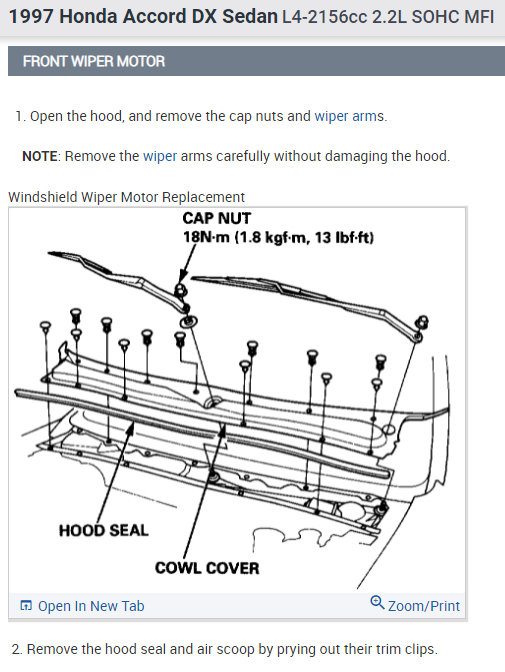

In order to replace the motor you will have remove the air scoop by taking off all of those fasteners. Then you will have access to the motor and gear assembly.
