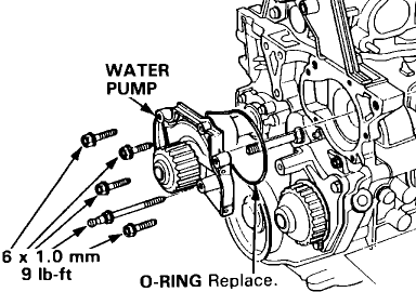

Where exactly is the water pump located?
Thursday, November 6th, 2008 AT 6:08 PM
MHPAUTOS
MECHANIC
31,937 POSTS
Hi there ,
The water pump is driven by the engine timing belt and the front covers have to be removed to access it, if replacing the pump it is a good idea to replace the belt as well.
