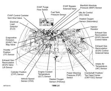

I know the fans work. The car is bubbling over into the overflow and boiling the coolant yet the car temp gauge inside the car says its normal. I have check the fuses and replaced the relay under the hood that is in with the fuses. I have bought an engine coolant temp sensor but idk where it goes. it looks like there are 2 of them on the car at each coolant hose end. I would love for any thoughts on what to do. Im on a budget and want to do this myself if possible. The cooling fan used to turn on when the car was off but i do know they work. [img:c293c456e7]http://www.2carpros.com/forum/automotive_pictures/527709_IMG_1699_1.jpg[/img:c293c456e7]
[img:c293c456e7]http://www.2carpros.com/forum/automotive_pictures/527709_IMG_1700_1.jpg[/img:c293c456e7]

The engine coolant temperature sensor see below pic The engine coolant temperature switch A is on right side of engine on cylinder head. The engine cooant temperature gauge switch B is on right side of engine.
https://images.2carpros.com/forum/automotive_pictures/12900_cts_42.jpg
