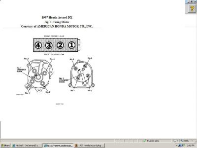

What is the spark plug wire diagram for a 1997 honda accord lx sedan 4cyl?

Hope ths is what you're looking for.
https://images.2carpros.com/forum/automotive_pictures/248092_97_honda_1.jpg
