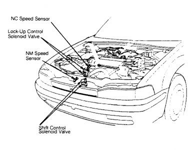

Thanks for the previous reply.
Where is the lockup solenoids located and what do they look like?
Hi lynndaddy,
P0740 = malfunction in lockup system.
Check for loose wire connections to lockup solenoids.
Is the ATF level correct and trans throttle cable adjusted correctly?

Hi lynndaddy, You should have used the reply to question link in initial post to continue so that whoever was attending to you can response when notification is received.
https://images.2carpros.com/forum/automotive_pictures/192750_Accord92ComponentLocation_1.jpg
