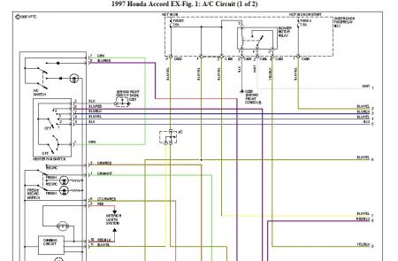

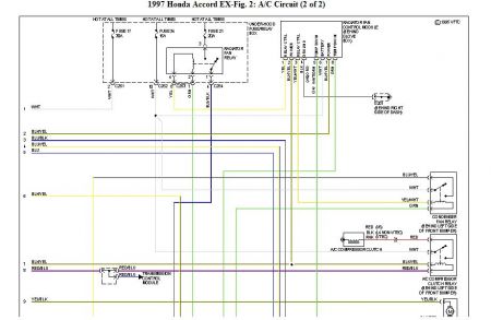

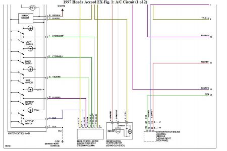

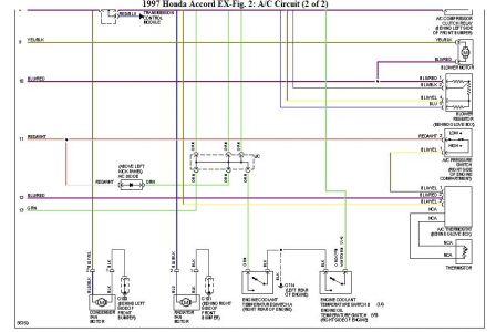

I bought a 97 honda accordand it got broken into the next day. Everything was working fine up to that point. They stole the stereo system ( not original). My A/c quit working and so did the radiator fan. I took in to a repair shop, they couldn't fix it for some reason and on top of that, the light signal and the tail lights quite working now . I got screwed and the repair shop wouldn't own up to it. So now my radiators fan, my ac/ heater blower , my light signal and my tail lights won't work. I checked all the fuses and looked for a short wire from the stereo , so far no luck. Any suggestions?
Feb 7, 2009 at 7:26 AM
KHLOW2008
  • 41,812 POSTS
Hi Sleiman, All these seems related and we shall start with the AC blower first. Test for power supply to blower motor connector with test lamp with ignition switch turned ON. There should be battery voltage on one wire if disconnected and both wires if plugged in. I have the circuit diagrams here for you.
https://images.2carpros.com/forum/automotive_pictures/192750_ACDiagram97Accord01a_1.jpg
https://images.2carpros.com/forum/automotive_pictures/192750_ACDiagram97Accord01b_1.jpg
https://images.2carpros.com/forum/automotive_pictures/192750_ACDiagram97Accord02a_1.jpg
https://images.2carpros.com/forum/automotive_pictures/192750_ACDiagram97Accord02b_1.jpg
