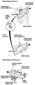

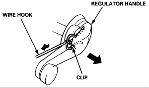

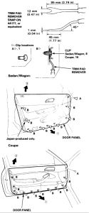

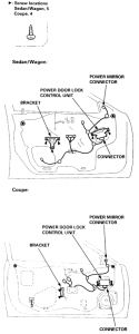

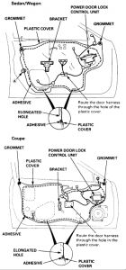

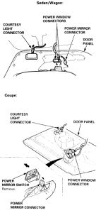

I'm having trouble removing the door panel. I have taken out the two screws and popped the plastic buttons down the sides of the door and along the bottom, but I still can't free the door panel from the door. Can you please help me.

If applicable, remove the regulator handle by pulling the clip out with a wire hook.
https://images.2carpros.com/forum/automotive_pictures/248015_2_27.gif
NOTE: Install the regulator handle so it points forward and up at a 45 degree angle with the glass closed.
https://images.2carpros.com/forum/automotive_pictures/248015_3_20.gif

Pull the inner handle forward and out half-way, and disconnect the inner handle rod and power door lock connector.
https://images.2carpros.com/forum/automotive_pictures/248015_5_9.jpg

Release the clips that hold the door panel. Remove the door panel by pulling it upward. NOTE : Remove the door panel with as little bending as possible to avoid creasing or breaking it.
https://images.2carpros.com/forum/automotive_pictures/248015_7_6.jpg
Disconnect the following: Power window connectors Power mirror connector (driver's) Courtesy light connector
https://images.2carpros.com/forum/automotive_pictures/248015_8_4.jpg
Remove the bracket and power door lock control unit, and disconnect the connectors.
https://images.2carpros.com/forum/automotive_pictures/248015_9_3.jpg
Detach the grommets and harness clips, then carefully remove the plastic cover.
https://images.2carpros.com/forum/automotive_pictures/248015_10_3.jpg
Before installing the plastic cover, make sure the door harness and connectors are fastened correctly on the door.
https://images.2carpros.com/forum/automotive_pictures/248015_11_2.jpg
Install the plastic cover and all removed parts. NOTE ; Apply adhesive along the edge where necessary to maintain a continuous seal and prevent water leaks. Do not plug the elongated holes. Sedan; To prevent contamination, cover the hole at location A with adhesive tape. Install the door panel. NOTE: Make sure the door harness is not pinched. If necessary, replace any damaged clips. Make sure the connectors are connected properly. Install) the armrest pocket (sedan/wagon, passenger's) and inner handle. NOTE : Make sure the connector is connected properly. If applicable, install the regulator handle. See: Front Door Handle\Service and Repair Install the mirror mount cover panel.
