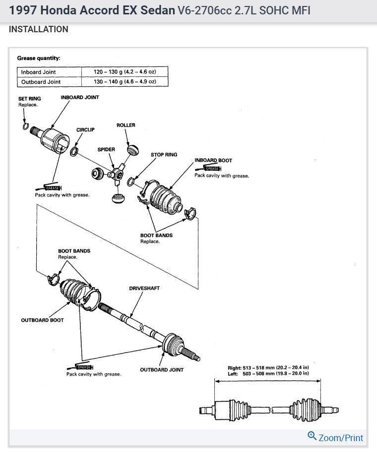

What's the steps in replacing the CV Joints?

You will need to remove the cross bolt on the lower control arm here is a guide and diagrams to help you and diagrams below to help you get the job done.
https://www.2carpros.com/articles/replace-cv-axle
and
https://www.2carpros.com/articles/how-a-cv-joint-works
