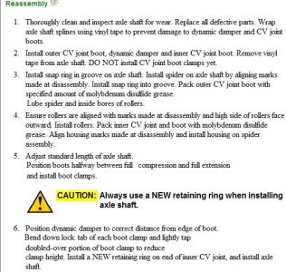

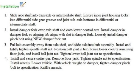

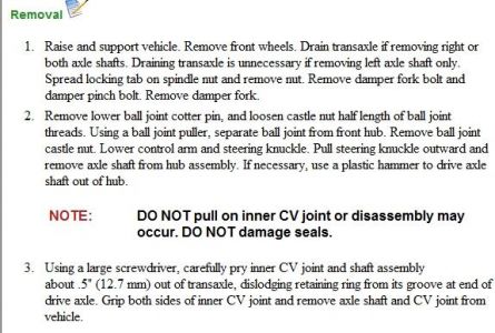

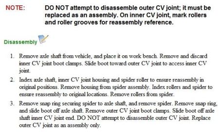

i need step by step instructions to put in a cv joint into the car.
Saturday, May 29th, 2010 AT 9:17 PM
BLUELIGHTNIN6
MECHANIC
16,542 POSTS
SPONSORED LINKS
Saturday, May 29th, 2010 AT 9:31 PM
