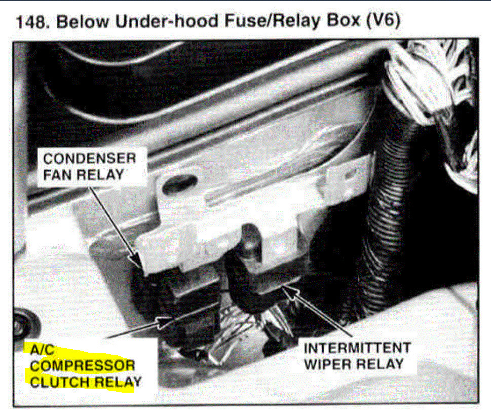

according to an OBDII scanner at auto zone trhe code is for a AC relay and what would be the fix and what relay are they talking about Thanks
Dec 29, 2008 at 4:09 AM
  • 110,244 POSTS
The code that you indicated isn't valid for this year, make, and model. However, I can help with the A/C compressor clutch relay.
A relay can cause the compressor to not operate. This relay is located under the fuse/relay box in the engine compartment. See pic 1 below.

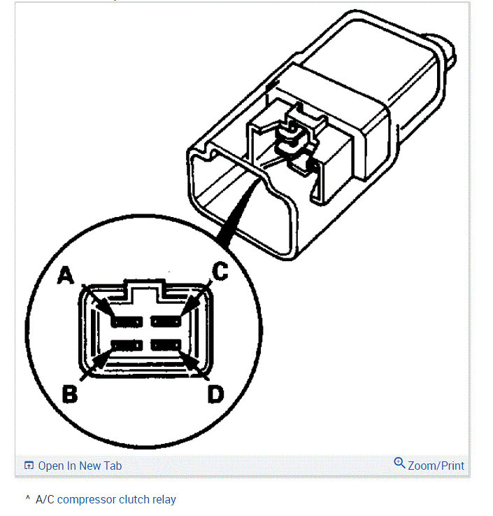

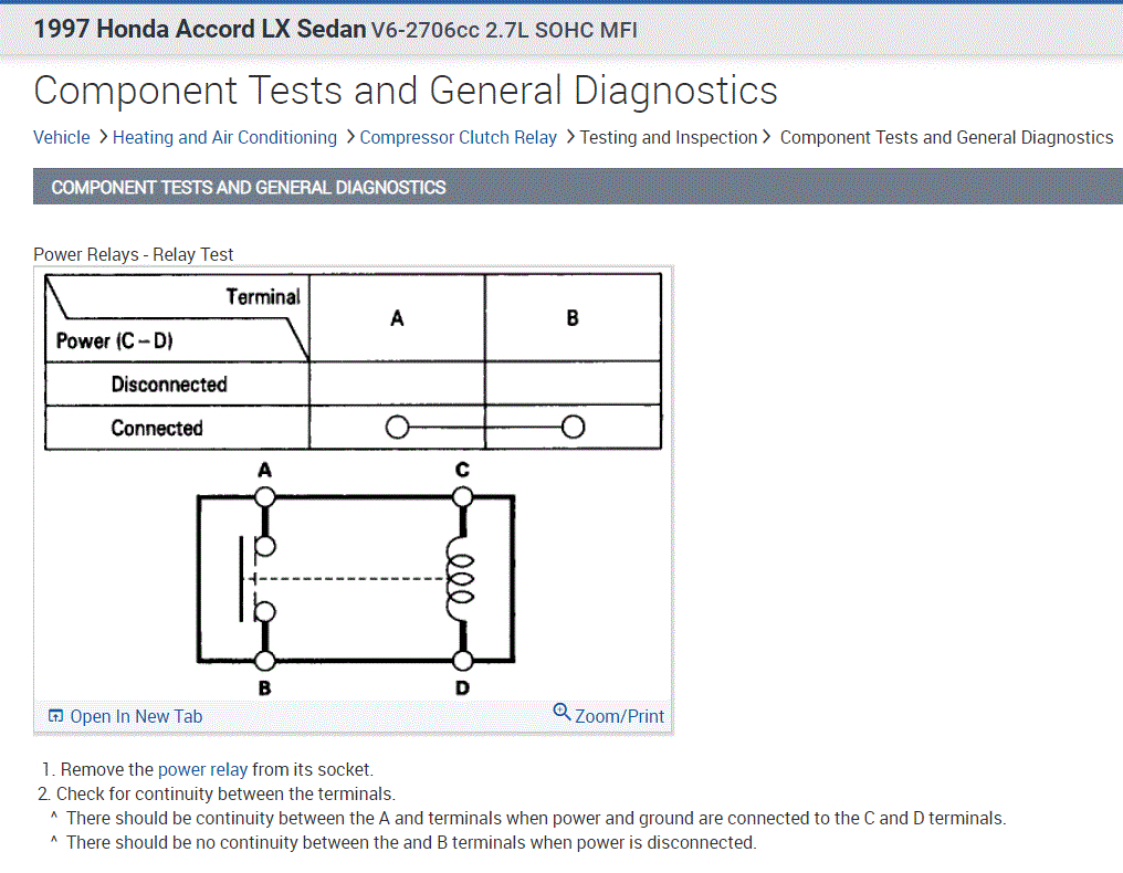

First, I would check the relay itself. Here is a link that explains how that is done:

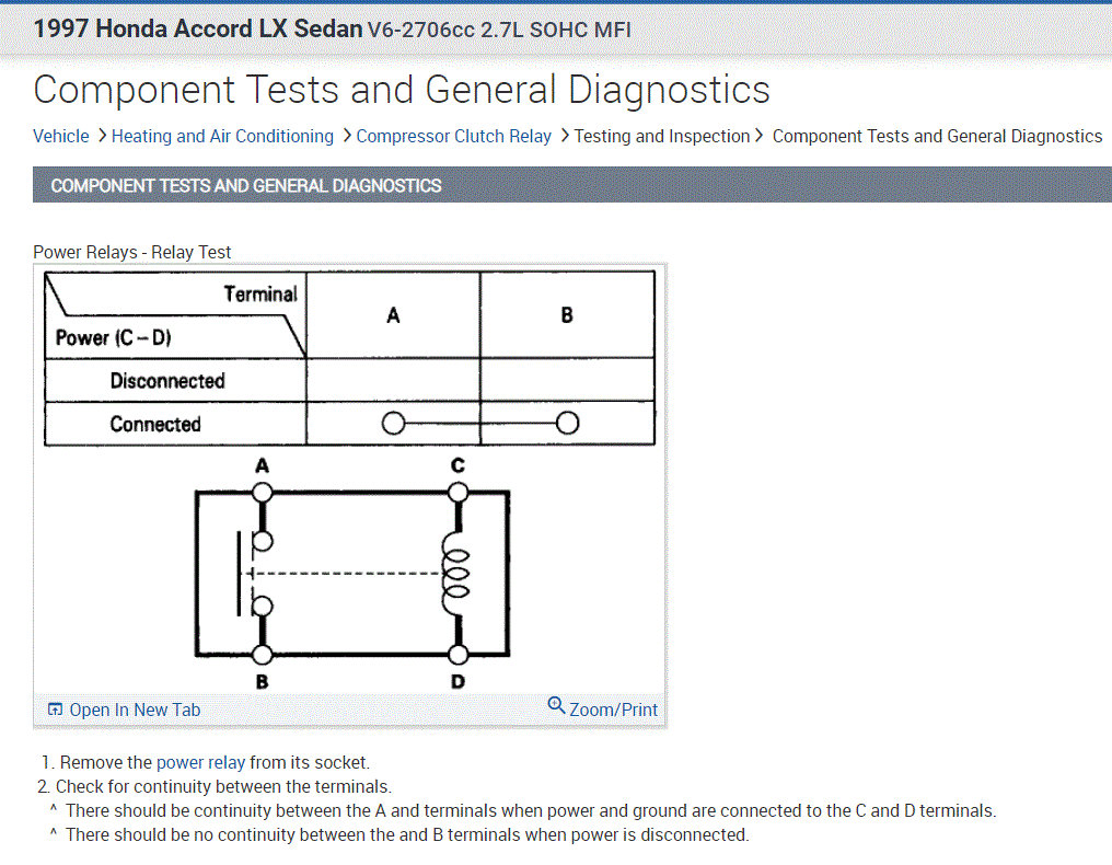

The remaining pics are the diagnostic related to the relay and compressor circuit.
See pics below. Note: The code you listed is not specific to any related code on this year and model.
