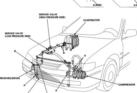

where do you add air conditioning coolant

Add the freon at the low pressure valve.See diagram below:
