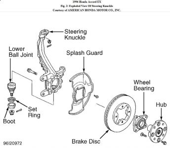

I am trying to replace some lug bolts on my girlfriends 1996 Honda Accord wagon. I am just wondering what all is involved in doing this and what tools I need. Any help would be great.

Hi The Third Pope, Thank you for the donation. Jack up vehicle and put on stand. Remove the front wheel. Remove CV shaft central nut. ( 36 mm socket box and impact wrench) Remove brake caliper and mount ( 12 mm, 14 mm and 17 mm ring or socket) Pull hub out slightly to enable lug bolts to be installed. ( Universal puller, hammer type) Knock out lugs to be replaced and install new lug bolts. Use lug nut to tighten to press the lugs into position. Reverse removal procedures.
https://images.2carpros.com/forum/automotive_pictures/192750_KnuckleFrt96AccordFig02_1.jpg
