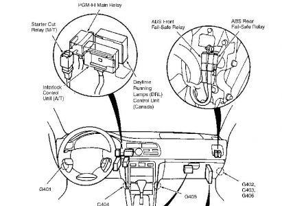

Hi HondaGirl29, Thank you for the donation. When engine stalled after starting, was it easy to restart? Is the Check Engine Lamp indicating while driving? Was any repairs carried out prior to this happening? One of the possible cause for the problem could be a faulty PGM-FI main relay. Remove the relay and check the circuit board for cracked solders at some of the joints. If any found, resolder them and retest.

The cold start valve, Idle Air control valve and throttle body are most likely to be the cause of stalling during initial start up.
I would suggest getting them cleaned and retest.
